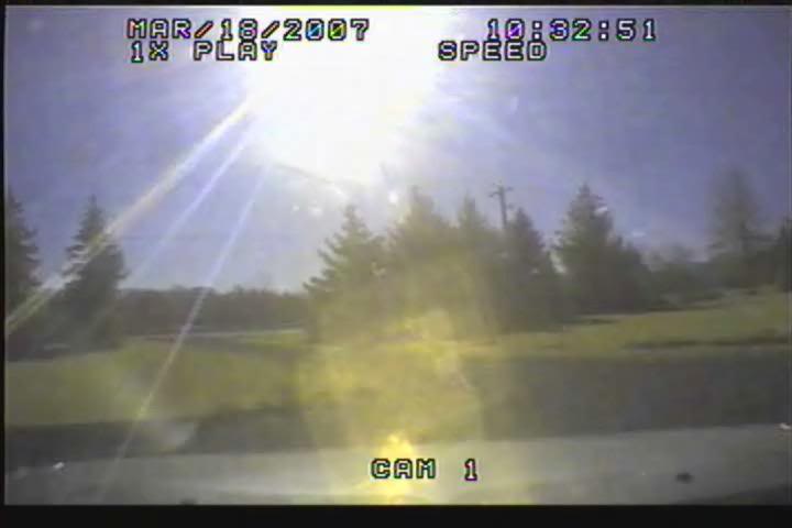

I installed a 4mm DC Auto-Iris lens and here's the result I get when looking at the sun.
The sun in completely in shot, but the camera is still able to see enough of the road (driveway in this case) to be useful. This camera is intended to provide evidence in an accident, and lane position, direction etc is all visible. This also allows me to aim the camera further up so I can see the status of traffic lights until I'm almost under them - another potentially vital piece of evidence in a collision.

As you can see in the above pic, grass appears as yellow. I thought this may be because of the sun - but I noticed today that the camera sees greens as yellow/orange.
I'm going to sawp the lens tonight to see if it's the camera or the lens. If it's the camera then I'll print out a color bar test and hold it up in front of the camera.
Is it possible for exposure to the sun without an auto-iris lens could damage the camera in a way that would make green look yellow? Could it be a bad lens?
