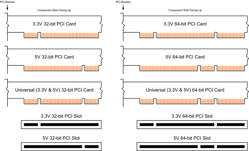

Ok, GV600-4
Just tested it in my PC, which has a Via Chipset where the GV250 and an Iview card worked fine before, but the Gv600 will not work, drivers would not even install.
Installed same card in an HP Desktop and a Dell Desktop, both had Intel Chipsets, Both refurbished from Tiger Direct, both 2.8 P4s, and both worked without problems. Tested with Geo 7.1 and 8.01. 7.1 was much faster overall and also seemed like the quality was a little better.

Well, I tried putting a GV2008 into a Dell PowerEdge 2900.
It cannot be done, due to the GV2008 being a 5-volt 32-bit PCI card, and the PowerEdge having a 3.3v 64-bit slot. The slot keying prevents this from working at all.
From Wikipedia:
Oh well, at least the Dell PE2900 server is off the list of possible options for the GV2008 anyway.
