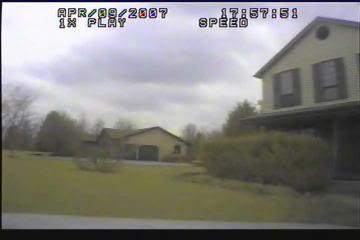

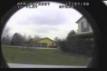

Two updates...
1) Here is a comparison of the Auto-iris lens versus a manual iris lens
THe manual iris lens is an accurate representation of the color of the grass and house. (The images were pixelated by the capture process for posting the pic to the web)

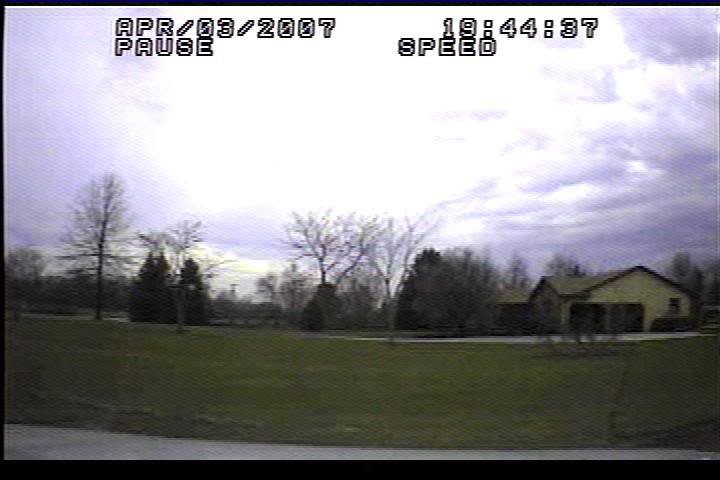

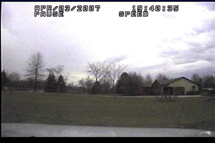

Update: Problem is fixed. The IR cut filter makes the grass appear green (what a concept).
It also means the camera can no longer see the light from the IR illuminator on the front of my house.
I'll post pics a little later on when I get a chance download the images from the car dvr.
Before:
After:
I just need to mount it permanently (so you can't see the black ring) and then adjust the focus/brightness/contrast again.
And yes, the house in the distance is slightly yellow in real life. No accounting for taste I guess.
Well yeah, no IR Cut filter makes the green in grass and shrubbery etc, washed out green, but the color was yellow in your images which confuses us all. Also the images are kind of blurry which makes it more difficult to see.
The images are kinda blurry because I'm always messing about with the camera and lens trying to figure this thing out. I have no idea why the grass appeared yelloe, but holding that filter up turned it back to green. I dunno - I'm not an expert. I've been ripping my hair out on this thing for a few weeks now and I'm just glad to be on the home stretch.
THe images would be blurry if I captured them right from the camera but they're being recorded by the DVR first then replayed and then paused - and then a tv capture card is used to grab the paused image and save it to a jpg. There's a chain-of-custody I woudln't like to explain in court.
