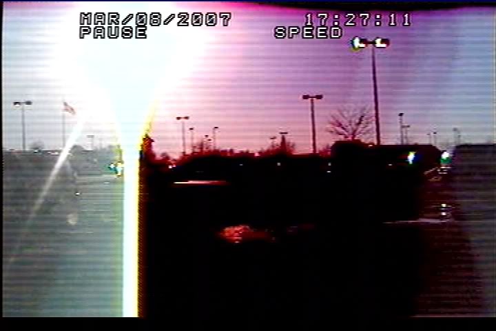

Scruit 0 Posted April 7, 2007 Here's an extreme example of smearing from my car camera before the auto-iris lens. The white vertical line is the smear. This image was take at midday on a clear day in full sun - yet the image is useless. After installing an auto-iris lens the smearing went away, although the image is still heavily impacted by the sun - the the image around the sun is at least usable. Share this post Link to post Share on other sites
