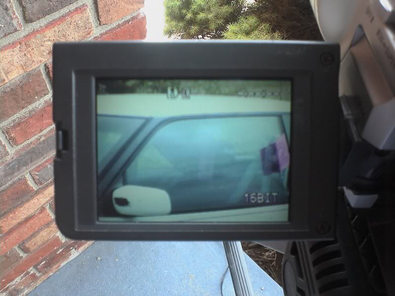

I set up the camcorder and pointed it at the car. Got the same result as last time, just a reflection of the sky. The pink paper taped to the outside ont he right edge of the pic proves the reflection is being captured.

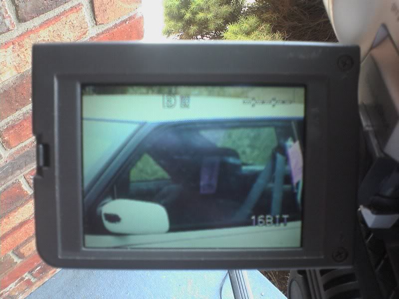

Now, I put my circular polarizing filter on the camera and adjusted it for best effect.
Note that you cannot see the reflection of the sky or the pink paper, and you can just make out the pink paper taped to the headrest inside - not visible in the before pic.
Interesting results...
