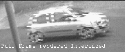

Here is a animation to explain -
Image of a moving car captured by a camera, with a lampost on the left for a fixed-point reference. As the car is moving fairly fast, it will have moved between the time the camera captures the first field, and the time it captures the second field. (remember a full frame picture is usually made up out of two feilds, odd and even lines)
The animation shows field one, then field two (one field will be all the odd lines, the other all the even lines. You will just have to imagine there is a blank line in between every line in field one and field two)
Then it shows them as a DVR rendered them de-interlaced (where it kindof merges the images, but you still get a ghost type effect on fast moving images)
Followed by finally the normal interlaced frame which is basically just the odd lines combined with the even lines from field one and field two - this has the jaggies as the car in field on has moved by the time the camera captured/sent field two.... So the car will be in a different position on the odd lines than it was on the even lines, if that makes sense....
as you can see there is a tradeoff, you either can display de-interlaced, but get the motion blur, or display interlaced and get the jaggies or displlay just a field, in which case only half the resolution... (thats not clear on the example though, its just a example!)
Some DVR's allow you to record both fields, and then give you the option of viewing either just one field, or both fields interlaced, or both fields de-interlaced - this is a good solution as you can switch views to get the best one depending on the content of the image.
