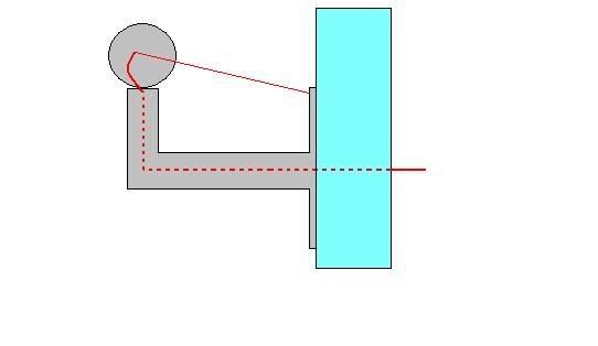

scorpion 0 Posted August 17, 2007 How do you attach the wire that comes out of the housing, and attaches to the mount? It sound like you have a "quick disconnect" connection at mount? The rope pulls the wire, and the "loop" is broken causing the alarm. I like this idea! I have never thought of that! Anyone have any cameras that have been shot? Share this post Link to post Share on other sites
sinbad 0 Posted August 17, 2007 I like the idea of the alarm on the cam. pretty smart Share this post Link to post Share on other sites
CraigVM62 0 Posted August 17, 2007 (edited) Why not use 2 good vandal proof Dome cameras (with IR's), and throw some silicon on the back when you mount them to "glue" them to the wall. They would be harder to steal and harder to tell what direction they are looking. I've had a lot of people think that "dome" cameras see 360 degrees so maybe some criminals think that too. Just a suggestion. A couple of reasons. If you mount a dome camera flush to an exposed outdoor wall, you now have major issues with water beading up on the dome distorting the image. Here in the Pacific North West we get plenty of rain. If you use a wall bracket to mount a dome facing down, your right back to giving them something to toss a rope around. Short of some commercial strength epoxy, I don't think glue is going to add much strength to the bracket. The new brackets are made of 1/4" steel angle iron / plate. They will be attached with 3/8" bolts going clear though the concrete walls and washers / bolts in the inside. I am guessing it will take a good 1000 lbs of downward pull to take this one down with some very strong rope. Scorp, Yes, the idea came from those pull apart disconnects that some use for overhead roll up doors and gates. In this case the wire is very small 28 gage 2 conductor wire. My only fear is if a pigeon or crow doesn't notice the wire and comes in for a landing on the bracket arm ...... whistles and bells I was called in to replace another companies camera that was shot at one of those commercial gas stations that don't have attendants and pumps require issued cards. I found a couple of BB's rolling around in the housing. The story was that a month before an individual came in and used his employers card to fill his own personal vehicle up with gas. They used footage from their cameras to prove what he had done and he was fired from his job. Soon after, new footage showed him walking up to one of the cameras and shooting it several times with a single pump, Daisy Red Rider type BB gun. I replaced the broken glass window of the housing with a piece of 3/16" Daisy proof Lexan. Edited August 17, 2007 by Guest Share this post Link to post Share on other sites

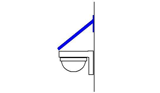

CraigVM62 0 Posted August 23, 2007 Rory, Since I only wish I had the IQ and mechanical ability to come up with a universal wiper system for domes... This is the best I could come up with. A simple metal mounting plate and perhaps 1" pipe cut at a 45 degree angle and welded to that plate. It would be mounted just above the dome and almost touching. I am guessing if a rope or chain was tossed over the dome wall bracket, they would just slip off ??? Maybe I could call it the "Dome Slipper" Still, even with a dome via a bracket / wall mount, there is the problem with water that is bouncing off the wall, splattering onto the lens. The lenses within would need to be pointed running along the wall. Right where the dome lens would get much of that splatter. The camera locations are around 14' off the ground so a bit higher off of the ground than the customers would want to ladder up to for cleaning. Heck, I hate having to go that high if I don't have to. Share this post Link to post Share on other sites
rory 0 Posted August 23, 2007 ahhh ..well cheap $50 bullet then replacing it wont bother their wallet Maybe you can find a wiper system for some RC cars or planes .. hook them up with 12VDC and bend them to fit on the dome .. Otherwise the Dome slipper may work .. Had some people pull down bullets before, though they were captured on the other bullet cameras as they did it .. Vandal domes, not yet, though I havent put many outdoors yet, the ones I did are either ceiling mounted or near a security booth, or in areas where they have to go through many other cameras first. Share this post Link to post Share on other sites
