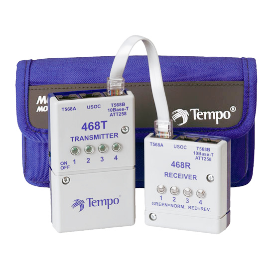

If at a minimum I would recommend this tool for checking your wires.
You can place one unit at one end of the wire run, and the other tool at the opposite side of the wire. This will tell you if you wired the plugs correctly, and it will tell you if the wires may have slipped when putting the ends on creating a crossed connection by mistake!
http://www.datacomtools.com/images3/tempo/cabletesters/larger/468.jpg

I am surprised that you do not have a tool similiar to it, considering how much computer work you do. I would think you would have to trouble shoot wires in the walls, wires from modems to routers, routers to PC, or DVRs ect.
I bought mine originally doing home wiring for structured homes. Now I find it greatful to have in the tool box all of the time.
I am checking phone wiring (cat 5), or networking wiring, or checking patch cables that I make on my own.
Once in a blue moon I catch another installer that "lost" it on the cable connector during application.

Rory, good luck. Unfortunately, a simple continuity check on CAT5 does not guarantee that you will be able to pass Ethernet traffic. I recently ran 6 cables - all checked out good with a cat5 tester - crimped rj45s on one end and keystone jacks at the other end. 5 of the 6 worked perfectly, but the last one did not. I cut off both ends of the bad connection and crimped them again. Still no joy. Most likely, there is a kink in the cable somewhere which allows the continuity test to pass, but won't allow 10/100 mbps to connect.
Thanks, yes thats what Im thinking also. Im going to meter the cables at different directions, regular meter that is, each pair but mix them up a bit, and see what I get. They ran it in conduit, mostly, but they also used some molding, I may have to trace the wire all the way back to see if there are any visual issues I can see .. no fun.
