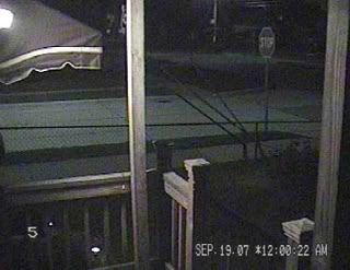

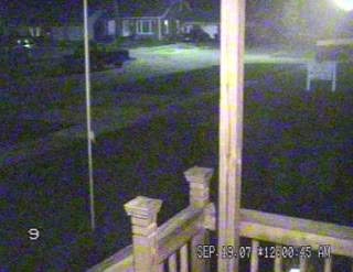

Metal Shaper Man 0 Posted September 19, 2007 Rory, I would say that you are very close on when Speco switched from ExView to whatever they use now. I bought some CVC637EX cameras at the very end of 2002 with ExView. In late 2004 and early 2005, I bought a couple more. When I got the cameras, they had changed it from a 6 mm lens to a 3.6 mm lens. At first, I thought it was just the lens causing the problem. But, when I called Speco about it they said they had just completely updated the camera. So, I exchanged the 637’s for some CVC6800’s with 6 mm Len’s. To cut a long story short, the image was clearer with less noise, but, less light sensitive. If I can get a minute within the next day or so, I will post some pics showing the difference between the newer cameras and the older ExView. I must add that I have never had any problem with the cameras considering how old some of them are. All I’ve noticed is what looks to be some fading from the 2002 637’s. I still have some CVC870’s purchased in mid 2002 that are still going too. Share this post Link to post Share on other sites

Metal Shaper Man 0 Posted September 21, 2007 These are examples of the early and later model CVC 637EX as mentioned above. Purchased in early 2003 with ExView. Purchased in late 2004 without ExView. I see this pic with less noise and less light sensitivity. Share this post Link to post Share on other sites
