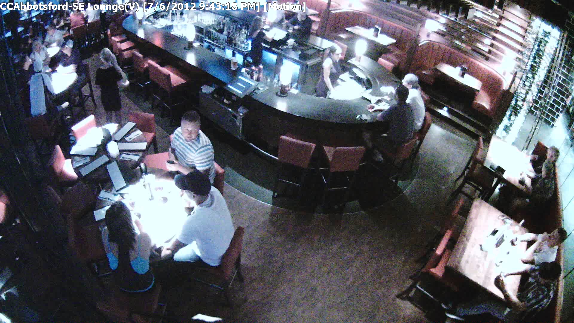

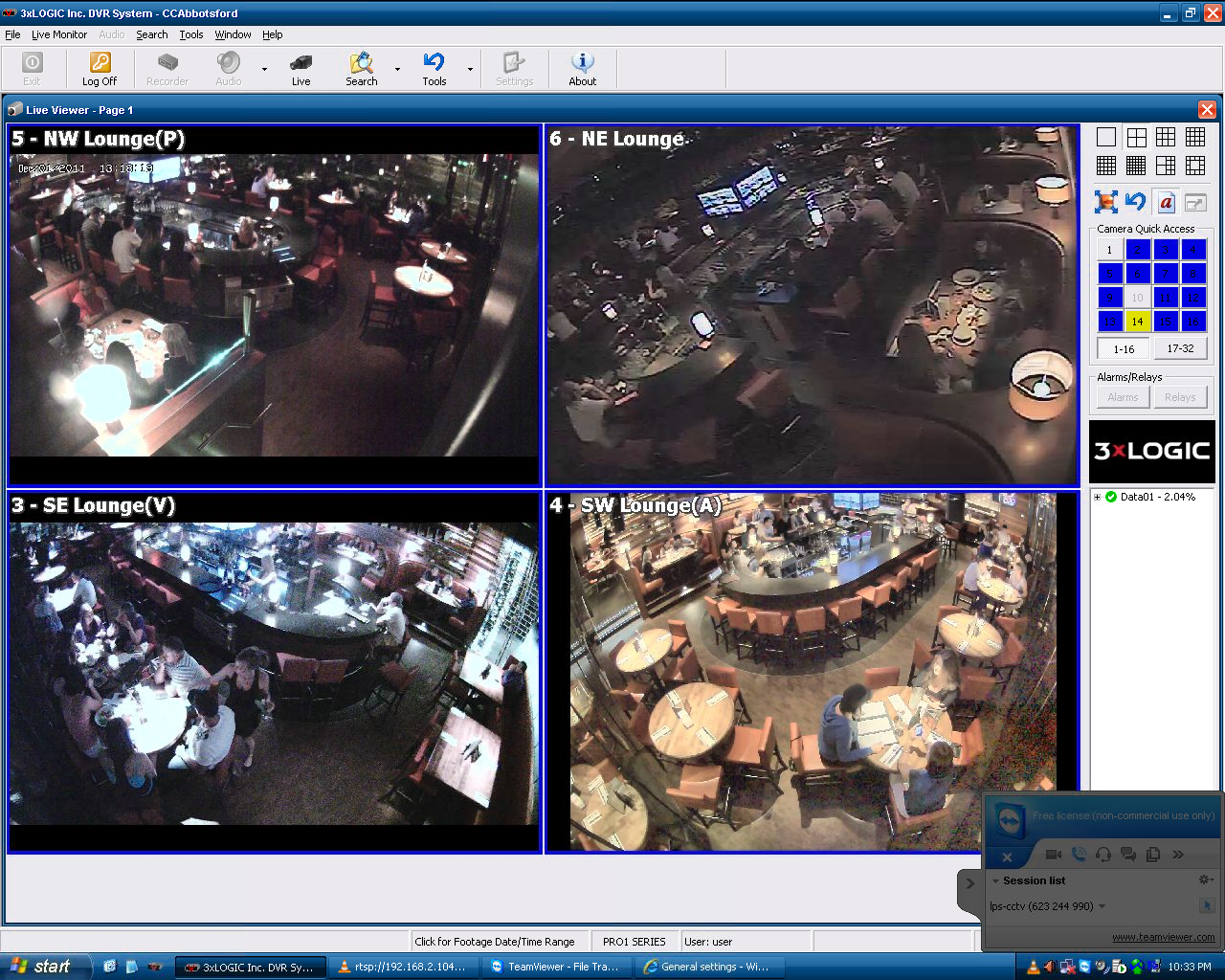

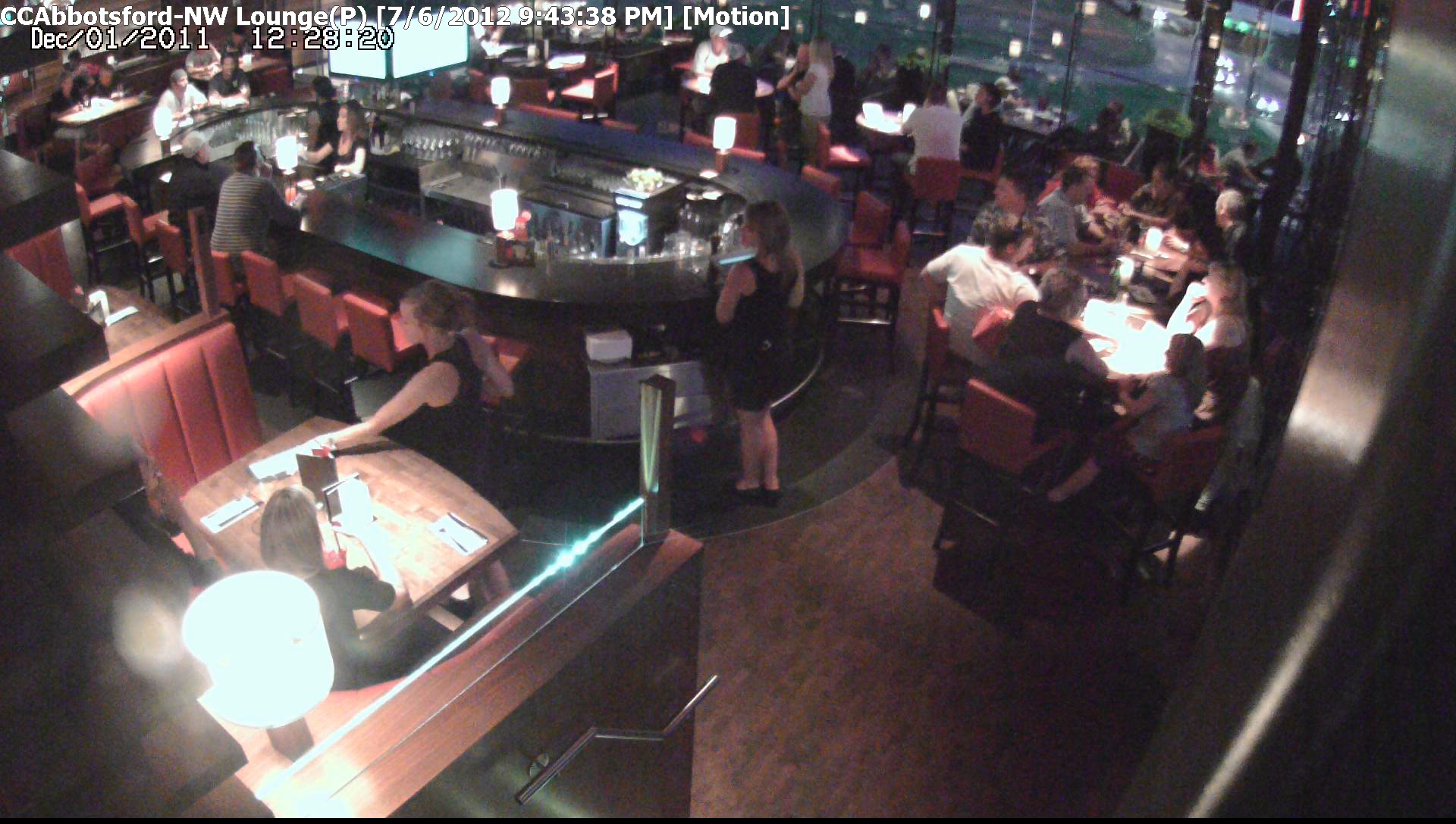

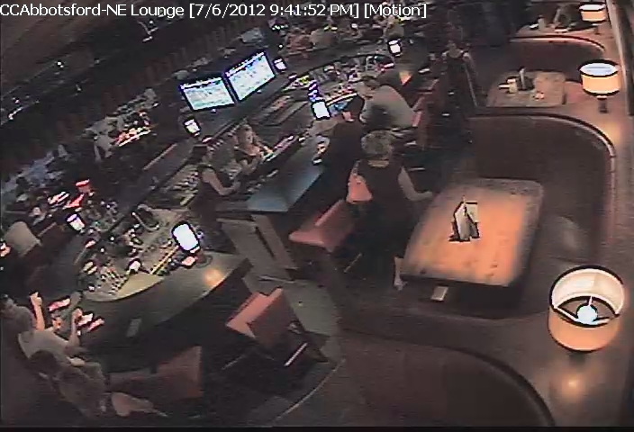

Soundy 1 Posted July 7, 2012 So, I got samples of three different low-light/WDR cameras from one of my suppliers, with the plan to install them in place of three of four CNB VCM-24VFs in the lounge of our main restaurant customer. Finally got them all in place this morning... just remoted in to see how things were looking in low light. Camera 6 is the CNB. On the others, (V) is the Vivotek FD-8162 (IR disabled), (P) is the brand spankin' new Panasonic VW-SW559, and (A) is the Axis Q1604. The Panasonic and Axis are running fully on default, out-of-the-box exposure settings... the Vivotek has the WDR options cranked but other than that, pretty sure it's on all defaults. The CNB has the SBLC cranked and DNR on MID, but otherwise is default exposures. Share this post Link to post Share on other sites
Soundy 1 Posted July 7, 2012 (edited) Full-size exports: CNB: Vivotek: Panasonic: Axis: Edited July 7, 2012 by Guest Share this post Link to post Share on other sites
nDAlk90 0 Posted July 7, 2012 Which one do you like the best? Thanks. Soundy said: Full-size exports: CNB: Panasonic: Vivotek: Axis: Share this post Link to post Share on other sites
