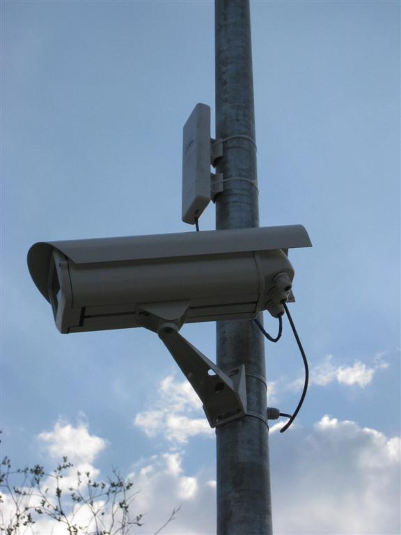

robert 0 Posted May 7, 2009 ACTi ACM-4200, 1.3mpix, ACTi megapixel lens(LEN-205/2.8-12mm) For that price, very good camera. Is that their cube camera and do you have it in a housing? Yes Share this post Link to post Share on other sites
thewireguys 3 Posted May 7, 2009 ACTi ACM-4200, 1.3mpix, ACTi megapixel lens(LEN-205/2.8-12mm) For that price, very good camera. Is that their cube camera and do you have it in a housing? Yes Also is that a var-focal lens your using? Share this post Link to post Share on other sites
robert 0 Posted May 7, 2009 ACTi ACM-4200, 1.3mpix, ACTi megapixel lens(LEN-205/2.8-12mm) For that price, very good camera. Is that their cube camera and do you have it in a housing? Yes Also is that a var-focal lens your using? Yes, it is ACTi "LEN-205",MegaPixel lens, CS, 2.8~12mm, 1/3", F1.6, Manual IRIS, day/night, 102.2~23.7 degrees horizontal F.O.V Cheap. Share this post Link to post Share on other sites
thewireguys 3 Posted May 8, 2009 ACTi ACM-4200, 1.3mpix, ACTi megapixel lens(LEN-205/2.8-12mm) For that price, very good camera. Is that their cube camera and do you have it in a housing? Yes Also is that a var-focal lens your using? Yes, it is ACTi "LEN-205",MegaPixel lens, CS, 2.8~12mm, 1/3", F1.6, Manual IRIS, day/night, 102.2~23.7 degrees horizontal F.O.V Cheap. You can't beat that for the price. How is the low light on that camera and what housing are you using? Share this post Link to post Share on other sites
robert 0 Posted May 8, 2009 ACTi ACM-4200, 1.3mpix, ACTi megapixel lens(LEN-205/2.8-12mm) For that price, very good camera. Is that their cube camera and do you have it in a housing? Yes Also is that a var-focal lens your using? Yes, it is ACTi "LEN-205",MegaPixel lens, CS, 2.8~12mm, 1/3", F1.6, Manual IRIS, day/night, 102.2~23.7 degrees horizontal F.O.V Cheap. You can't beat that for the price. How is the low light on that camera and what housing are you using? I dont have night time images. But there are two 500w lights. So, plenty. Customer is happy, so I am. Just and ordinary outdoor heated housing from Taiwan. Share this post Link to post Share on other sites
thewireguys 3 Posted May 8, 2009 ACTi ACM-4200, 1.3mpix, ACTi megapixel lens(LEN-205/2.8-12mm) For that price, very good camera. Is that their cube camera and do you have it in a housing? Yes Also is that a var-focal lens your using? Yes, it is ACTi "LEN-205",MegaPixel lens, CS, 2.8~12mm, 1/3", F1.6, Manual IRIS, day/night, 102.2~23.7 degrees horizontal F.O.V Cheap. You can't beat that for the price. How is the low light on that camera and what housing are you using? I dont have night time images. But there are two 500w lights. So, plenty. Customer is happy, so I am. Just and ordinary outdoor heated housing from Taiwan. How are you powering the camera, housing and AP with one cat5? I know the camera is POE and so is the AP. Thank you for the info Share this post Link to post Share on other sites
robert 0 Posted May 10, 2009 How are you powering the camera, housing and AP with one cat5? I know the camera is POE and so is the AP. Thank you for the info Camera is powered from 220v(but works on 3.3v), also the housing. Then there is PoE injector which runs LAN with power to AP on the mast. I`m taking 220v from lamp post. Share this post Link to post Share on other sites
robert 0 Posted July 20, 2009 How much does that camera cost? and the lens? I am assuming you work with megapixel cameras a lot. Found lense here, not that expensive http://www.bhphotovideo.com/bnh/controller/home?O=&Q=&IC=CA6004LISEF&A=RetrieveSku There is even 800m version: http://www.bhphotovideo.com/bnh/controller/home?O=&A=RetrieveSku&IC=CA80056LISEF&Q= Nice stuff Share this post Link to post Share on other sites
