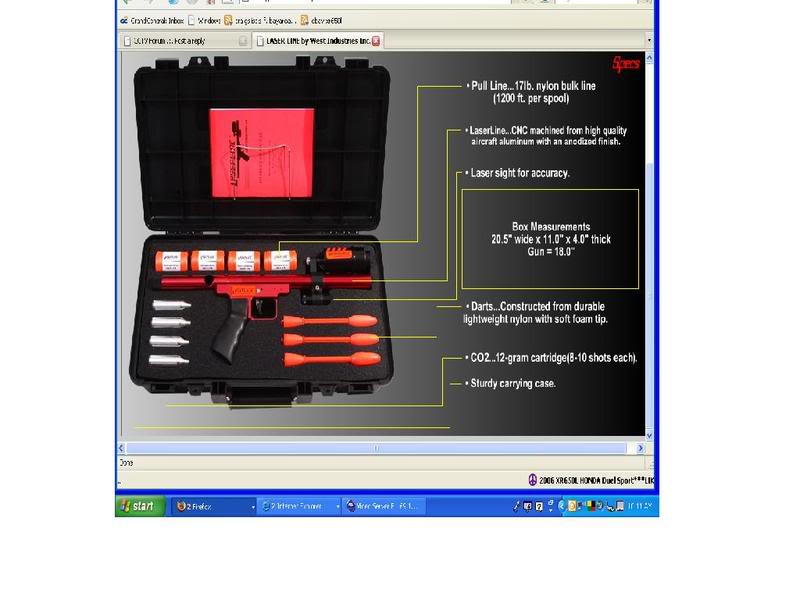

C7 in CA 0 Posted February 17, 2008 I tried a cable caster once. unfortunately it tangled almost immediately. I remember not being able to open the closed spin caster reel and it got thrown in a box somewhere. So I have to say I was not impressed. Besides as others have mentioned; All the ceilings I work in are already packed full of other mechanical services. Between duct work, conduit, and ceiling wires you would have to be dead-on with every shot to beat the speed and accuracy of glow rods and boom poles. Also, I am suppose to install cable supports every 4 feet. So I have to open every other ceiling tile anyway. That being said... I like new toys as much as the next guy. If I had any more room on the truck I might be tempted to pickup one of these: http://thelaserline.com/ Share this post Link to post Share on other sites
