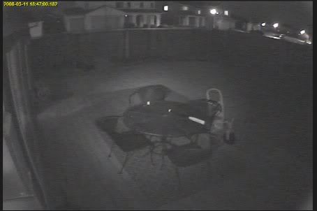

I have a snapshot of this camera. It's not bad, but I'm getting the "check your FTP settings" error message when I try to post a .jpg.
Is this on my end? I cant figure it out and I have successfully posted images in the past.

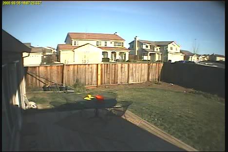

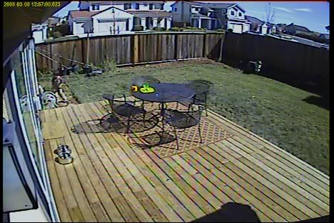

C7, thanks for the link to photobucket and your offer to post for me. It seems to have worked thru photobucket.
HQ1 Bullet - the dark areas at top right and left are from the detachable sunshade. I could not push it back any further. I guess this is a downside. Sorry no night shot. I guess I could remount this and grab one if anyone is interested.
